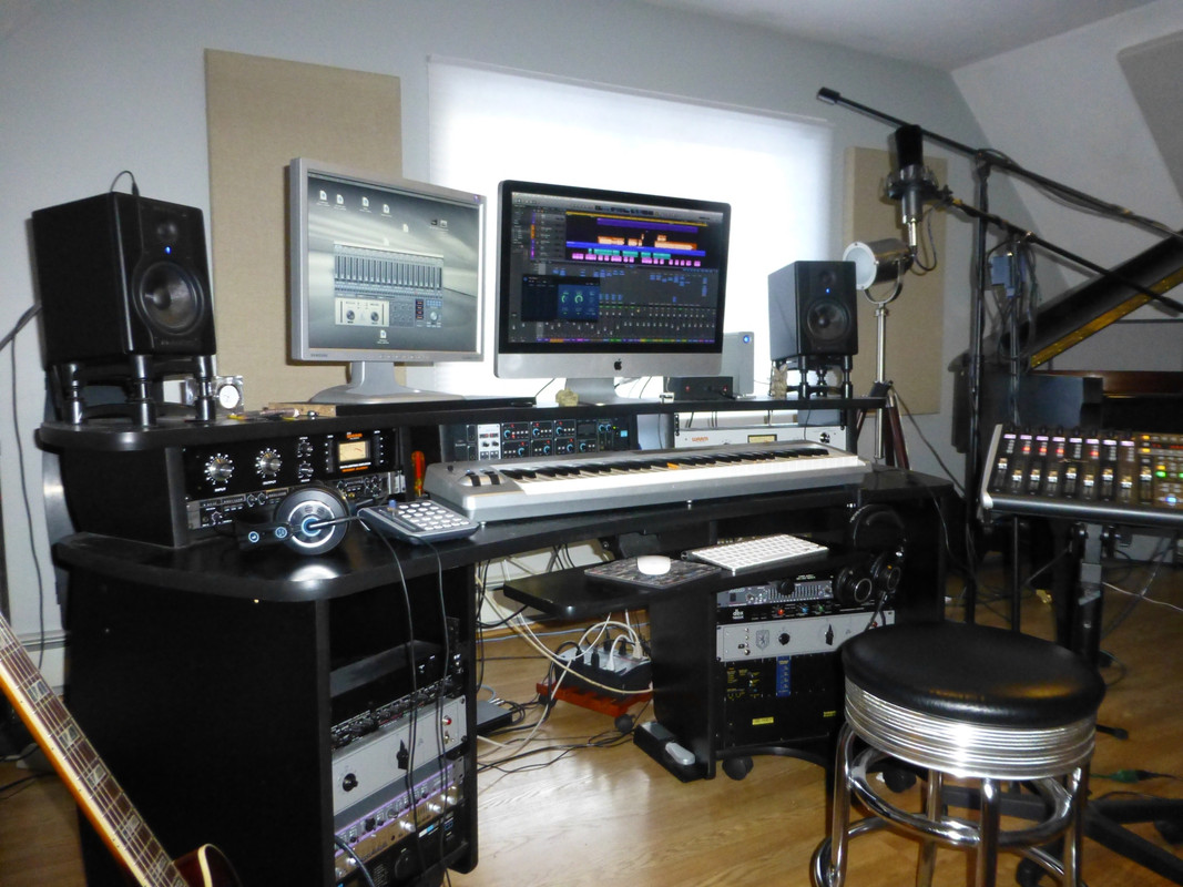

They need to sit on their sides, right? With nearly 15" of width each because I currently have a 4 space lunchbox on the upper tier, I'd have to reconfigure my desk a bit. It's nearly 6' across, but with two big 27" monitors taking up a good swath of it, things will be tight. I'd be sitting only 3' away from the tweeters, with along with my head will make a 90 degree isosceles triangle. That sound about right? Here's an older pic. Most of the hardware is different, but I'm using the same screens so you can see it will be a squeeze. Or perhaps do they need to be more distant from the chair?

Post by kcatthedog on Nov 22, 2022 18:26:35 GMT -6
Ragan and shadow have/had them so hopefully they chime in!
I have my 2 visual monitors stacked vertically; frees up some horizontal space.
Post by M57 on Nov 22, 2022 18:32:26 GMT -6
..I have my 2 visual monitors stacked vertically.. That would freak me out! lol
