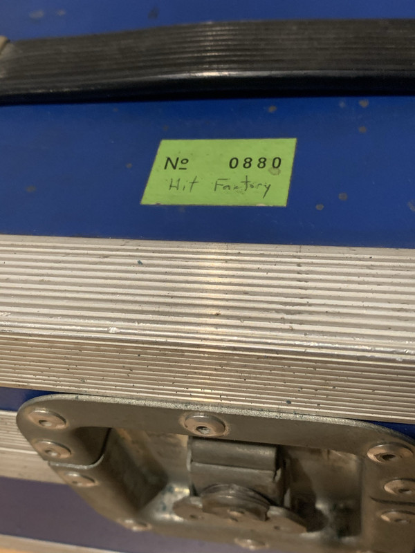

I have a hit factory headstack (with identifying markings I won’t take pics of) and likely from a machine in these pics, & mentioned on their 353 wiki page. The narrow machine is also a 24track, as you can see by John’s elbow in one of the pics. The Dave Spindell pic shows the wide body cal covers only off on 1-16, so it might be using it in that pic..
