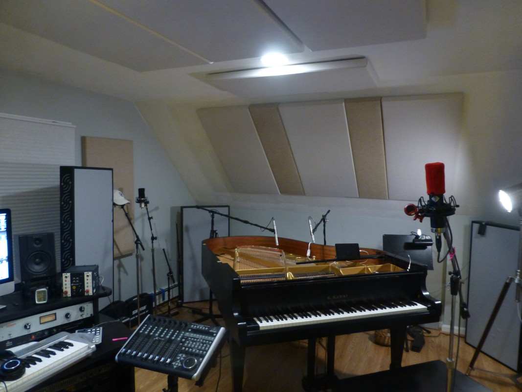

What are the room dimensions? It's the space above a garage.. L shaped because there's a bathroom built into one corner. Maybe 500 square feet. It has s gabled roof starting at about 4" from the floor on the long sides that slope 45 degrees to the ceiling resulting in a ~30' x 20' flat ceiling long ways. I actually think the resulting odd space is probably a good thing. I just found a pic from a year or so ago. You're looking at about 30% of the total area. The other 45 side is treated similarly.

Looks great, a simple possible fix would be proper stands and check placement of monitors to see how much you might be able to tame the area.
For mixing you don't mention using sonarworks which can help.
For recording solutions, super chunk corner traps would be much better, every 2-3 way wall joint is essentially another corner I see no soffit absorbers ?
I'd do the super chunk corners first, create space behind your 4 inch panels and you can recover them and under the material put in 6 ml vapour barrier say start with half of them as this still absorbs the mid and bass but reflects some of the high so not to dead.
A localized free problem sort of cries out for a helmholtz but as you likely there are differences of opinions about that.
If you have space at rear wall you could build a deep helmholtz absorber 10-12 inches and cover with wld slats with varying gaps tuned to the problematic freq range ?

Looking at those pics I’d suggest doing more with your ceiling cloud. I’ve worked in more than a few small rooms and in all of them the ceiling cloud made one of the biggest difference when applying absorption.
I’d try 6” traps suspended off the ceiling just a few inches. Could be a dramatic difference in your mix position.
Post by M57 on Jan 19, 2021 16:50:52 GMT -6
Looking at those pics I’d suggest doing more with your ceiling cloud. I’d try 6” traps suspended off the ceiling just a few inches. Could be a dramatic difference in your mix position. Yeah, they're just 2" panels with wood backs (with two more on the other side), so I know they're not doing much of anything from the lower-mids on down. I hate to have to install big ol' honkin panels on the ceiling. I'm hoping more effective corner traps work. I'm pretty much a headphone mixer. Really, the main goal is to get good sounding recordings. Truth be told, my monitors are crap. They're M-Audio BX5's. So before I sink any more money into mix-related treatment, I'd be picking up a good pair of monitors. I've got the Focal Twins on my wish list. Still, I don't doubt that suspended traps would make a difference when recording too - I'm just thinking that taming bass in the corners should probably be a higher priority. Thanks for your suggestions Tbone81 . I'm definitely keeping them in my back pocket as I consider my options.
Post by hadaja on Jan 19, 2021 21:33:00 GMT -6
Just out of curiosity whats the black mic on the stand with the red pop screen?
Post by M57 on Jan 20, 2021 5:41:18 GMT -6
Just out of curiosity whats the black mic on the stand with the red pop screen? Blackspade UM4X. It's the one I used on the vocal for the song linked in the first post of this thread. I didn't use a de-esser, but I'm a very sibilant singer, so with all of my vocals I go in and use clip gain on about 75% of the esses and other similar miscreant sibilances ..usually attenuating somewhere between 3 and 6 db. Oh, and it's not a pop-screen. It's just a cover. I never sing directly at the mic, so I don't use a screen.
