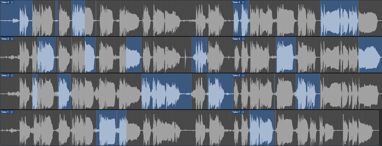

As a DIY singer/songwriter I've gone through a couple of different phases in terms of how I track lead vocals. More recently I've been 'chunkifying' the song and singing a single verse/chorus at a time. Based how things go I usually put in around 3-5 takes, then move on. After I've recorded the entire song, and while comping the takes I usually need to re-record a line here and there. I've always felt that one major advantage of the system is that I remember exactly what each take feels like and can reproduce what I like and fix or experiment with what I don't like on each subsequent take. But the other day, for some reason I just let the virtual tape roll and sang it all the way through ..four times. Here's how I ended up comping the takes. For whatever reason, there was no need to punch any individual lines. Surprisingly I got pretty much everything I needed despite the fact that with each subsequent take I wasn't really aware of where previous sub-par performances were. Unexpectedly, generally speaking I feel like I sang more in tune than when I record using my usual system. Looking at which take I pulled each line from, it looks like I was peaking in takes 2 and 3 ..which if I recall is about the same with the chunkify system. Certainly, I used less actual recording time. I don't know that I'm going to switch my system, but the session was eye-opening for me. I'm curious how others approach tracking vocals ..both in DIY settings and when they're sitting behind the desk tracking others.

For lead vocals, I typically record every section of the song separately and do 3 - 6 takes per section. Comp the good bits onto a single lead vocal track.
From there, it depends on how fussy/nitpicky I want to be. I usually like to have a double and a triple panned hard L/R. If it's session work, I usually just comp these from unused lead vocal takes. But for personal stuff, I like to comp/tune/edit the lead vocal first and then record another 3 - 4 takes per section for the double/triple, just to get the timing as close as humanly possible before using Vocalign.
Everything else (i.e. harmonies, backgrounds, etc.) usually gets two takes to use as a stereo pair. Generally less picky about these than I am with leads. I also loooooooove having a single low octave panned center underneath the lead vocal. Doesn't always work, but it's a great way to add extra heft to choruses, especially with other harmonies/BGVs going on.
